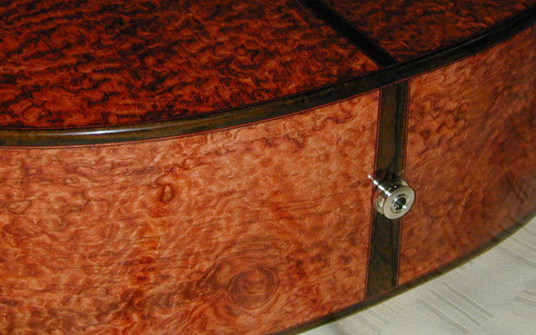

Clinton, here is a quilted bubinga done with Ziricote bindings, purf is blk/orange/blk ... dark browns, with black lines, sometimes shows somewhat of a really deep olive colour in there too ... see the spiderweb graining on the tailwedge ... also when dead on quarter, has really nice fleck spots to it ..

PostPosted: Fri Jan 05, 2007 2:00 am
Hey Tony, the wood on that Git is all deformed!

PostPosted: Fri Jan 05, 2007 3:21 am
Yeah, that tree was on DRUGS man .... some whacked out natural herbs or somethin' ...
